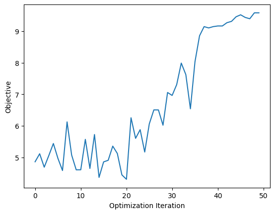

Maximization problem#
[3]:
# Create the optimizer & solve maximization problem (for a pseudo random function of binary variable)
# Size of the binary variable
problem_dimension = 10
optimizer = BinaryReinforceOptimizer(configs=configs)
[4]:
# Solve
maximization_results = optimizer.solve()

[5]:
# Plot
show_optimization_results(maximization_results)
Optimal Design: [False  True False  True False False  True  True  True  True]
Optimal Objective Value: 9.581017261196408
Optimal Plicy: [0. 1. 0. 1. 0. 0. 1. 1. 1. 1.]
Design Sample [1]: [False  True False  True False False  True  True  True  True];  Objective = 9.581017261196408
Design Sample [2]: [False  True False  True False False  True  True  True  True];  Objective = 9.581017261196408
Design Sample [3]: [False  True False  True False False  True  True  True  True];  Objective = 9.581017261196408
Design Sample [4]: [False  True False  True False False  True  True  True  True];  Objective = 9.581017261196408
Design Sample [5]: [False  True False  True False False  True  True  True  True];  Objective = 9.581017261196408
../_images/tutorials_binary_optimization_6_1.png

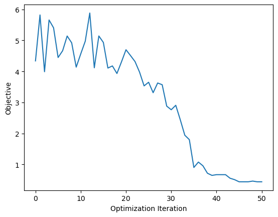

Minimization problem#
You can either recreate the optimizer with configuration maximize set to False, or simply update this configuration as follows
[6]:
# Set the optimization objective to minimization
optimizer.update_configurations(maximize=False)
# Solve & Plot
minimization_results = optimizer.solve()
show_optimization_results(minimization_results)

Optimal Design: [ True  True  True  True False False False False  True False]
Optimal Objective Value: 0.4426718163463439
Optimal Plicy: [1. 1. 1. 1. 0. 0. 0. 0. 1. 0.]
Design Sample [1]: [ True  True  True  True False False False False  True False];  Objective = 0.4426718163463439
Design Sample [2]: [ True  True  True  True False False False False  True False];  Objective = 0.4426718163463439
Design Sample [3]: [ True  True  True  True False False False False  True False];  Objective = 0.4426718163463439
Design Sample [4]: [ True  True  True  True False False False False  True False];  Objective = 0.4426718163463439
Design Sample [5]: [ True  True  True  True False False False False  True False];  Objective = 0.4426718163463439
../_images/tutorials_binary_optimization_8_1.png
