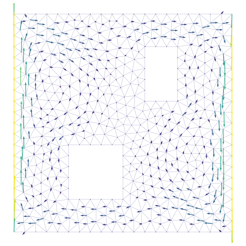

# Plot the domain
model.plot_domain()
model.plot_velocity_field()

from pyoed.models.error_models import Laplacian
configs = dict(Vh=model.parameter_dof,
mean=model.parameter_vector(init_val=0.5),
gamma=1.0,
delta=16,
random_seed=123,
prior = Laplacian.DolfinBiLaplacianErrorModel(configs)
/opt/homebrew/Caskroom/miniconda/base/envs/pyoed-dev/lib/python3.12/site-packages/ffc/jitcompiler.py:234: QuadratureRepresentationDeprecationWarning:
*** FFC: quadrature representation is deprecated! It will ***
*** likely be removed in 2018.2.0 release. Use uflacs ***
*** representation instead. ***
issue_deprecation_warning()

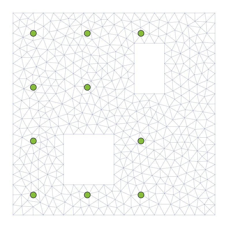

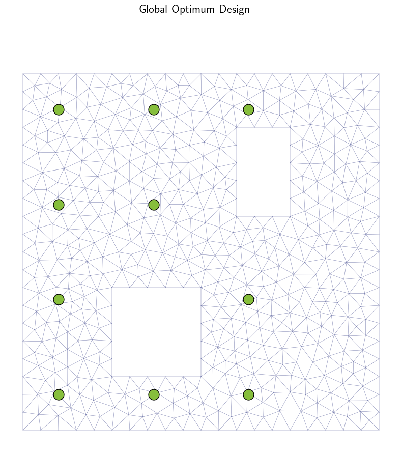

# Create observation operator (5 candidate sensor points)
num_candidate_sensors = 10
from pyoed.models.observation_operators.fenics_observation_operators import(
create_pointwise_observation_operator,
obs_oper = create_pointwise_observation_operator(model=model,
num_obs_points=num_candidate_sensors, )
# Display the observtion grid
_ = model.plot_domain(sensors_coordinates=obs_oper.get_observation_grid())

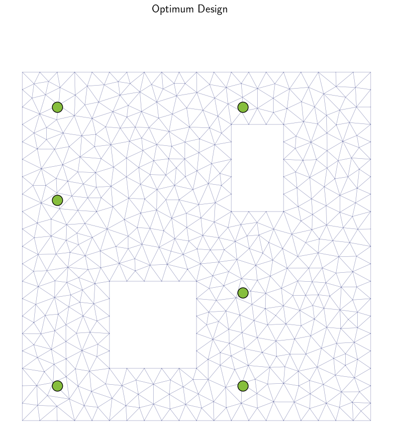

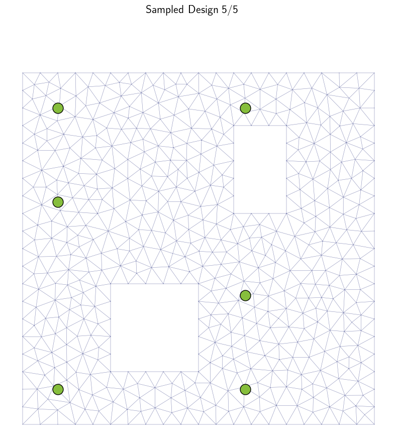

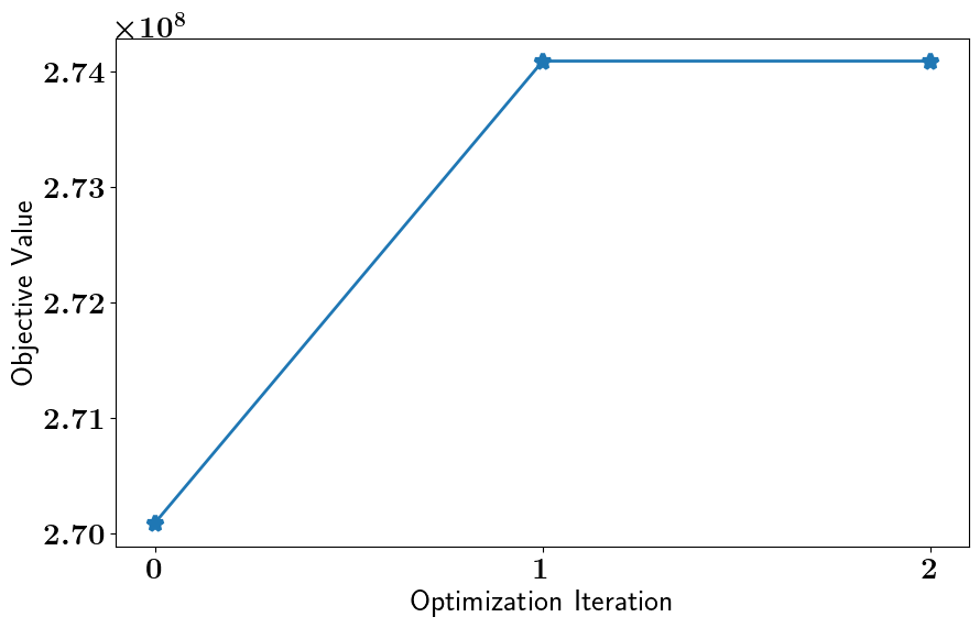

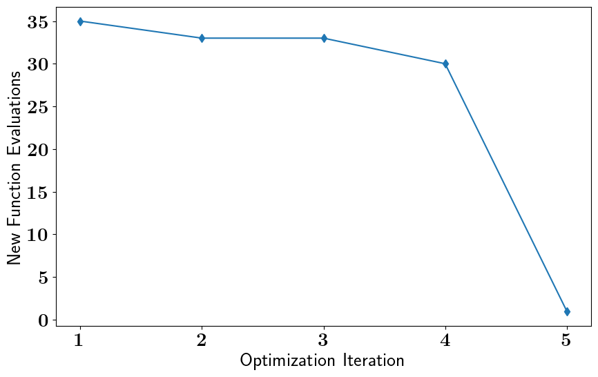

[9]:
from pyoed.oed.sensor_placement.binary_oed import SensorPlacementBinaryOED
stochastic_oed_problem = SensorPlacementBinaryOED(
configs=dict(
inverse_problem=inverse_problem,
criterion="A-opt",
use_FIM=True,
evaluation_method="randomized",
optimization_settings={
"def_stepsize":1e-6,
"decay_step":True,
"maxiter": 100,
[10]:
if False:
# Register penalty/regularization term
penalty_weight = 0 # Negative as the objective (trace of the FIM below)
penalty_f = lambda design: np.count_nonzero(design)
stochastic_oed_problem.register_penalty_term(penalty_function=penalty_f,
penalty_weight=penalty_weight,
[12]:
# Solve the OED problem

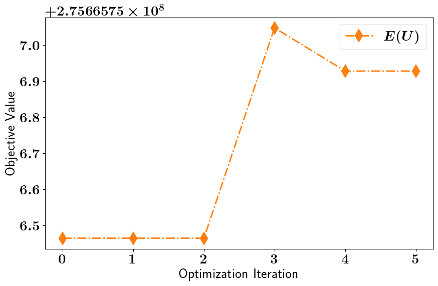

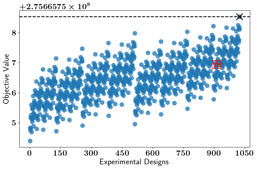

stochastic_oed_results = stochastic_oed_problem.solve_oed_problem(verbose=True)
Solving the Binary OED problem using Stochastic RL learning approach...
* BinaryReinforceOptimizer: Binary Optimization via Stochastic Learning
Parameters:
Objective : maximize
def_stepsize : 1e-06
Newton_step : False
decay_step : True
stochastic gradient sample size : 36
optimal_baseline_batch_size : 12
optimal_baseline_epochs : 3
maxiter : 100
pgtol : 1e-09
baseline : optimal
antithetic : True
Evaluate Objective Value for design with index: 00569; Not found; calculating --> Objective Value = 275665756.13501585
Evaluate Objective Value for design with index: 00133; Not found; calculating --> Objective Value = 275665755.13776094
Evaluate Objective Value for design with index: 00182; Not found; calculating --> Objective Value = 275665756.4555818
Evaluate Objective Value for design with index: 00921; Not found; calculating --> Objective Value = 275665756.56744623
Evaluate Objective Value for design with index: 00077; Not found; calculating --> Objective Value = 275665755.48070234
Evaluate Objective Value for design with index: 00795; Not found; calculating --> Objective Value = 275665756.5884699
Evaluate Objective Value for design with index: 00034; Not found; calculating --> Objective Value = 275665755.2281375
Evaluate Objective Value for design with index: 00604; Not found; calculating --> Objective Value = 275665756.88761574
Evaluate Objective Value for design with index: 00312; Not found; calculating --> Objective Value = 275665756.9826125
Evaluate Objective Value for design with index: 00722; Not found; calculating --> Objective Value = 275665756.57224953
Evaluate Objective Value for design with index: 00887; Not found; calculating --> Objective Value = 275665757.4803
Evaluate Objective Value for design with index: 00447; Not found; calculating --> Objective Value = 275665757.1688872
Evaluate Objective Value for design with index: 00160; Not found; calculating --> Objective Value = 275665756.6973712
Evaluate Objective Value for design with index: 00597; Not found; calculating --> Objective Value = 275665756.23120666
Evaluate Objective Value for design with index: 00367; Not found; calculating --> Objective Value = 275665756.7297957
Evaluate Objective Value for design with index: 00464; Not found; calculating --> Objective Value = 275665757.08852947
Evaluate Objective Value for design with index: 00943; Not found; calculating --> Objective Value = 275665757.23835254
Evaluate Objective Value for design with index: 00485; Not found; calculating --> Objective Value = 275665756.4144297
Evaluate Objective Value for design with index: 00886; Not found; calculating --> Objective Value = 275665757.56734395
Evaluate Objective Value for design with index: 00559; Not found; calculating --> Objective Value = 275665756.4081026
Evaluate Objective Value for design with index: 00020; Not found; calculating --> Objective Value = 275665755.66327524
Evaluate Objective Value for design with index: 00348; Not found; calculating --> Objective Value = 275665756.8364666
Evaluate Objective Value for design with index: 00242; Not found; calculating --> Objective Value = 275665756.41291326
Evaluate Objective Value for design with index: 00649; Not found; calculating --> Objective Value = 275665755.57374865
Evaluate Objective Value for design with index: 00961; Not found; calculating --> Objective Value = 275665756.1582554
Evaluate Objective Value for design with index: 00272; Not found; calculating --> Objective Value = 275665756.39144456
Evaluate Objective Value for design with index: 00739; Not found; calculating --> Objective Value = 275665756.39533484
Evaluate Objective Value for design with index: 00172; Not found; calculating --> Objective Value = 275665756.19198954
Evaluate Objective Value for design with index: 00914; Not found; calculating --> Objective Value = 275665756.70541453
Evaluate Objective Value for design with index: 00996; Not found; calculating --> Objective Value = 275665757.3336524
Evaluate Objective Value for design with index: 00490; Not found; calculating --> Objective Value = 275665756.72557193
Evaluate Objective Value for design with index: 00006; Not found; calculating --> Objective Value = 275665755.2458284
Evaluate Objective Value for design with index: 00602; Not found; calculating --> Objective Value = 275665756.542349
Evaluate Objective Value for design with index: 00805; Not found; calculating --> Objective Value = 275665756.2745005
Evaluate Objective Value for design with index: 00203; Not found; calculating --> Objective Value = 275665755.7347014
Evaluate Objective Value for design with index: 00887; Found in history & Loaded --> Objective Value = 275665757.4803
Evaluating optimal baseline...
Evaluate Objective Value for design with index: 00203; Found in history & Loaded --> Objective Value = 275665755.7347014
Evaluate Objective Value for design with index: 00724; Not found; calculating --> Objective Value = 275665756.91751635
Evaluate Objective Value for design with index: 00256; Not found; calculating --> Objective Value = 275665757.4680329
Evaluate Objective Value for design with index: 00037; Not found; calculating --> Objective Value = 275665755.21133757
Evaluate Objective Value for design with index: 00450; Not found; calculating --> Objective Value = 275665756.0334101
Evaluate Objective Value for design with index: 00807; Not found; calculating --> Objective Value = 275665756.6197673
Evaluate Objective Value for design with index: 00515; Not found; calculating --> Objective Value = 275665755.3004301
Evaluate Objective Value for design with index: 00026; Not found; calculating --> Objective Value = 275665755.6123508
Evaluate Objective Value for design with index: 00247; Not found; calculating --> Objective Value = 275665756.74138004
Evaluate Objective Value for design with index: 00972; Not found; calculating --> Objective Value = 275665757.23017496
Evaluate Objective Value for design with index: 00654; Not found; calculating --> Objective Value = 275665756.42156976
Evaluate Objective Value for design with index: 00931; Not found; calculating --> Objective Value = 275665756.52849966
Evaluate Objective Value for design with index: 00888; Not found; calculating --> Objective Value = 275665757.91261053
Evaluate Objective Value for design with index: 00391; Not found; calculating --> Objective Value = 275665755.9890346
Evaluate Objective Value for design with index: 00553; Not found; calculating --> Objective Value = 275665755.6473253
Evaluate Objective Value for design with index: 00812; Not found; calculating --> Objective Value = 275665756.9309095
Evaluate Objective Value for design with index: 00053; Not found; calculating --> Objective Value = 275665755.69902825
Evaluate Objective Value for design with index: 00202; Not found; calculating --> Objective Value = 275665755.82174516
Evaluate Objective Value for design with index: 00711; Not found; calculating --> Objective Value = 275665756.4130256
Evaluate Objective Value for design with index: 00953; Not found; calculating --> Objective Value = 275665756.965266

Done...
REINFORCE Iteration: 5 ; Step-Update-Norm: 0.0
CONVERGED: PROJECTED GRADIENT NORM <= PGTOL
Number of Iterations: 5
Number of Function Evaluations: 247
Evaluate Objective Value for design with index: 00910; Found in history & Loaded --> Objective Value = 275665756.9275768
* DONE; Terminating...
- Converged? True
- Info: CONVERGED: PROJECTED GRADIENT NORM <= PGTOL

# Calculate the objective for all candidate solutions (by bruteforce for evaluation)
stochastic_oed_results.update_bruteforce_results()
[14]:
stochastic_oed_results.plot_results(overwrite=True, keep_plots=True, )
Plotting Binary/Stochastic OED Results...
Saving/Plotting Results to: /Users/attia/AHMED_HOME/Research/Projects/Software/PyOED/Branches/32-update-oed-interface-to-conform-to-the-unified-configs-arguments/pyoed/pyoed/examples/tutorials/Optimization_Iterations.pdf
Saving/Plotting Results to: /Users/attia/AHMED_HOME/Research/Projects/Software/PyOED/Branches/32-update-oed-interface-to-conform-to-the-unified-configs-arguments/pyoed/pyoed/examples/tutorials/BruteForce_ScatterPlot.pdf
Saving/Plotting Results to: /Users/attia/AHMED_HOME/Research/Projects/Software/PyOED/Branches/32-update-oed-interface-to-conform-to-the-unified-configs-arguments/pyoed/pyoed/examples/tutorials/Clustered_BruteForce_ScatterPlot.pdf
Plot saved to: '/Users/attia/AHMED_HOME/Research/Projects/Software/PyOED/Branches/32-update-oed-interface-to-conform-to-the-unified-configs-arguments/pyoed/pyoed/examples/tutorials/global_optimum_design.pdf'
Plot saved to: '/Users/attia/AHMED_HOME/Research/Projects/Software/PyOED/Branches/32-update-oed-interface-to-conform-to-the-unified-configs-arguments/pyoed/pyoed/examples/tutorials/optimal_design.pdf'
Plot saved to: '/Users/attia/AHMED_HOME/Research/Projects/Software/PyOED/Branches/32-update-oed-interface-to-conform-to-the-unified-configs-arguments/pyoed/pyoed/examples/tutorials/optimum_design_sample1.pdf'
Plot saved to: '/Users/attia/AHMED_HOME/Research/Projects/Software/PyOED/Branches/32-update-oed-interface-to-conform-to-the-unified-configs-arguments/pyoed/pyoed/examples/tutorials/optimum_design_sample2.pdf'
Plot saved to: '/Users/attia/AHMED_HOME/Research/Projects/Software/PyOED/Branches/32-update-oed-interface-to-conform-to-the-unified-configs-arguments/pyoed/pyoed/examples/tutorials/optimum_design_sample3.pdf'
Plot saved to: '/Users/attia/AHMED_HOME/Research/Projects/Software/PyOED/Branches/32-update-oed-interface-to-conform-to-the-unified-configs-arguments/pyoed/pyoed/examples/tutorials/optimum_design_sample4.pdf'
Plot saved to: '/Users/attia/AHMED_HOME/Research/Projects/Software/PyOED/Branches/32-update-oed-interface-to-conform-to-the-unified-configs-arguments/pyoed/pyoed/examples/tutorials/optimum_design_sample5.pdf'
Saving/Plotting Results to: /Users/attia/AHMED_HOME/Research/Projects/Software/PyOED/Branches/32-update-oed-interface-to-conform-to-the-unified-configs-arguments/pyoed/pyoed/examples/tutorials/Optimization_Iterations_FunctionEvaluations.pdf

relaxed_oed_results = relaxed_oed_problem.solve_oed_problem(verbose=True, )
Solving the Relaxed OED
/Users/attia/AHMED_HOME/Research/Projects/Software/PyOED/Branches/32-update-oed-interface-to-conform-to-the-unified-configs-arguments/pyoed/pyoed/oed/sensor_placement/relaxed_oed.py:945: OptimizeWarning: Unknown solver options: verbose
res = sp_optimize.minimize(
SCIPY Optimization using (L-BFGS-B):
Success: True
CONVERGENCE: REL_REDUCTION_OF_F_<=_FACTR*EPSMCH
[18]:
relaxed_oed_results.plot_results(overwrite=True, keep_plots=True, )
Plotting Relaxed OED Results...
[19]:
relaxed_oed_results.optimal_design
[19]:
array([0.14048161, 0.19754815, 0.31885533, 0. , 0.56386185,
0.29339233, 0.46126252, 0.23947539, 0.39237066, 0.39275163])
